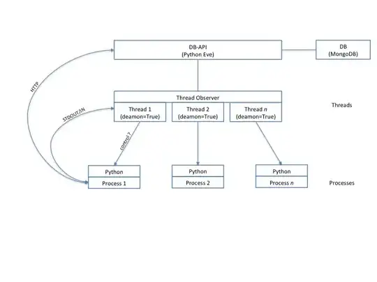

In order to start those parallel calculations as own (sub)processes I thought about using something like a parent thread which are observed by another thread called 'thread observer'. Since each of these calculation processes needs access to the database I thought about using the eve-API in combination with the requests module.
All in all these thoughts lead to the setup like the following:
schema
Based on this concept I am not sure about how to control the subprocess from its parent thread. How can I make sure that Process 1 is terminated if Thread 1 terminates?

Start with the Python 2 and Python 3 multiprocessing package having classes like Process with Queue and Pipe to exchange messages between them on all platforms where Python runs. You seem to be interested in the Pool class of multiprocessing to control worker processes. It is a different style of control than the usual fork/exec, wait, and signals.
