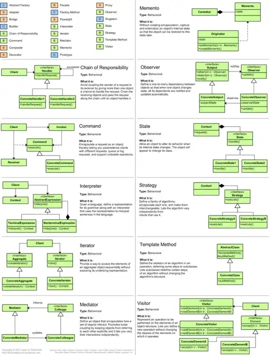

First, lets look at GoF design patterns : GoF design patterns
Here, it is quite obvious, that every interface is not defined by the implementer, but by the client. Every pattern allows for arbitrary number and types of implementers. But if client changes, so does the interface. That means the interface and client are more closely conceptually related than interface and implementer.
