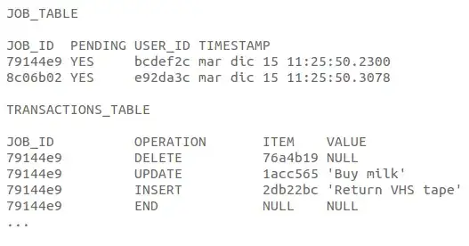

  • Syncing between multiple clients is a very complext task.
  • Let's not call it syncing, let's call it bash transaction processing.
  • Let's get rid of "last server update timestamp", let's just every transaction be inserted into a pre-process table with a timestamp generated by the server.
  • Let's make it asyncronous. If data is processed fast enough, users shouldn't notice.
  • Client generates a job id (hash of userid plus timestamp plus some other randon data), and pushes it to the server.
  • Server saves the job id in a jobs table and assigns it a timestamp
  • Client sends transactions that will be in that job enter image description here
    ITEM ID is client generated using a hash function the same way job id was generated.
  • A process that runs, say every few seconds gets the more recent pending job, and proceeds to process all transactions.
  • Transactions that couldn't be done because the ITEM was previously erased are inserted in a rejects table
  • Current data after transaction is pushed to client including rejections (client data is deleted and new data is inserted, client perceives it as a refresh)
  • A jobs can be transanction-less, meaning it's only a refresh request.
  • Overwrites cannot be avoided but you can opt to duplicate entries when a conflict arises instead of overwriting the older version of an item.

  • wow this is entirely different than everything I implemented so far... so serialise all the operations in so to say a queue? I assume there would be only 1 worker thread then? Why do you say overwrites cannot be avoided? (the -1 is not from me btw) – User Dec 15 '15 at 16:41
  • Yes, one thread. Overwrites are unavoidable since you cannot prevent a later transaction to overwrite the change you previously made, neither with my approach or yours, although I've seen that Apple just duplicates some entries when there's a conflict, when syncing notes, which is weird since nobody else is syncing my notes. I'll add an edit to the overwrites part. – Tulains Córdova Dec 15 '15 at 17:51
