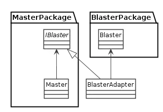

The magic of introducing an IBlaster interface is that MasterPackage and BlasterPackage can work together without having a direct dependency relationship, and without being written by the same person/team/organization. Usually, this is not done by putting IBlaster into a separate package that both modules depend on. Instead, IBlaster would be part of MasterPackage, and you would introduce an adapter module. The dependencies can be illustrated like this:
an UML diagram illustrating that MasterPackage and BlasterPackage do not have to be directly connected
The adapter depends on both packages, but the Master only depends on IBlaster. Such adapters get extremely useful when writing unit tests, and wanting to mock out the BlasterPackage. Of course, the MasterPackage will require some conforming adapter to be provided, but there is no concrete dependency on the BlasterAdapter. Even when you make all dependencies explicit and configurable, at some point the interface consumers and interface providers will have to be connected (dependency injection).
