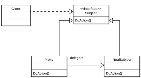

Given the example where you want to unit test some code that does CORBA or other remote call.
During the test phase you don't have the proper environment online. Refactoring this concern and creating a proper testable code can be achieved with a Proxy pattern, where your concrete proxy implementation would delegate the calls to another concrete class. That enables the separation of concerns quoted on your question.
UML of a PROXY Pattern
Then during a integration test you can actually test the remote behaviour.
