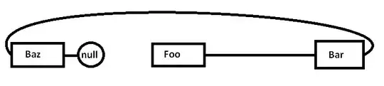

Chasing Pointers Around
Assume we have a singly-linked list like:
Foo->Bar->Baz->null
The problem is that if we allocate all these nodes separately against a general-purpose allocator (and possibly not all at once), the actual memory might be dispersed somewhat like this (simplified diagram):

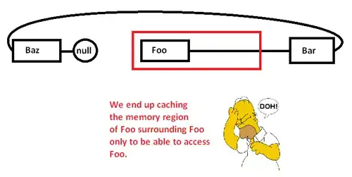

When we start chasing pointers around and access the Foo node, we start off with a compulsory miss (and possibly a page fault) moving a chunk from its memory region from slower regions of memory to faster regions of memory, like so:
This causes us to cache (possibly also page) a memory region only to access a portion of it and evict the rest as we chase pointers around this list. By taking control over the memory allocator, however, we can allocate such a list contiguously like so:

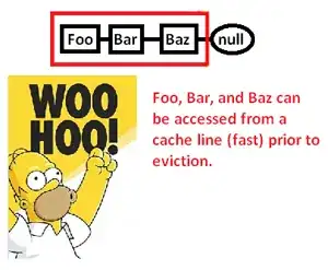

... and thereby significantly improve the speed at which we can dereference these pointers and process their pointees. So, albeit very indirect, we can speed up pointer access this way. Of course if we just stored these contiguously in an array, we wouldn't have this issue in the first place, but the memory allocator here giving us explicit control over memory layout can save the day when a linked structure is required.
* Note: this is a very oversimplified diagram and discussion about the memory hierarchy and locality of reference, but hopefully it's appropriate for the level of the question.
