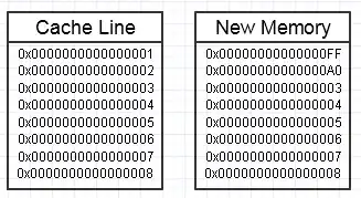

Coming from the low-level standpoint, if we x-ray concepts like objects and strings and so forth, at the heart of it is just bits and bytes in various forms of memory with different speed/size characteristics (speed and size of memory hardware typically being mutually exclusive).
The memory hierarchy of the computer likes it when we repeatedly access the same chunk of memory, such as in the above diagram, since it'll keep that frequently-accessed chunk of memory in the fastest form of memory (L1 cache, e.g., which is almost as fast as a register). We might repeatedly access the exact same memory (reusing it multiple times) or repeatedly access different sections of the chunk (ex: looping through the elements in a contiguous chunk which repeatedly accesses various sections of that chunk of memory).
We end up throwing a wrench in that process if modifying this memory ends up wanting to create a whole new memory block on the side, like so:
... in this case, accessing the new memory block could require compulsory page faults and cache misses to move it back into the fastest forms of memory (all the way into a register). That can be a real performance killer.
There are ways to mitigate this, however, using a reserve pool of preallocated memory, already touched.

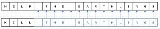

Another conceptual issue that arises from a slightly higher-level view is simply doing unnecessary copies of really big aggregates in bulk.
To avoid an overly complex diagram, let's imagine this simple memory block was somehow expensive (maybe UTF-32 characters on an unbelievably limited hardware).
In this case, if we wanted to replace "HELP" with "KILL" and this memory block was immutable, we would have to create a whole new block in its entirety to make a unique new object, even though only portions of it have changed:
Stretching our imagination quite a bit, this kind of deep copy of everything else just to make one little part unique might be quite expensive (in real-world cases, this memory block would be much, much bigger to pose a problem).
However, in spite of such an expense, this kind of design will tend to be far less prone to human error. Anyone who has worked in a functional language with pure functions can probably appreciate this, and especially in multithreaded cases where we can multithread such code without a care in the world. In general, human programmers tend to trip over state changes, especially ones that cause external side effects to states outside of a current function's scope. Even recovering from an external error (exception) in such a case can be incredibly difficult with mutable external state changes in the mix.
One way to mitigate this redundant copying work is to make these memory blocks into a collection of pointers (or references) to characters, like so:
Apologies, I failed to realize we don't need to make L unique while making the diagram.
Blue indicates shallow copied data.

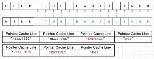

... unfortunately, this would get incredibly expensive to pay a pointer/reference cost per character. Furthermore, we might scatter the contents of the characters all over the address space and end up paying for it in the form of a boatload of page faults and cache misses, easily making this solution even worse than copying the entire thing in its entirety.
Even if we were careful to allocate these characters contiguously, say the machine can load 8 characters and 8 pointers to a character into a cache line. We end up loading memory like this to traverse the new string:
In this case, we end up requiring 7 different cache lines worth of contiguous memory to be loaded to traverse this string, when ideally we only need 3.

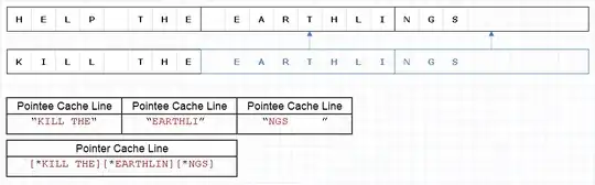

Chunk Up The Data
To mitigate the issue above, we can apply the same basic strategy but at a coarser level of 8 characters, e.g.
The result requires 4 cache lines worth of data (1 for the 3 pointers, and 3 for the characters) to be loaded to traverse this string which is only 1 short of the theoretical optimum.
So that's not bad at all. There's some memory waste but memory is plentiful and using up more doesn't slow things down if the extra memory is just going to be cold data not frequently accessed. It's only for the hot, contiguous data where reduced memory use and speed often go hand-in-hand where we want to fit more memory into a single page or cache line and access it all prior to eviction. This representation is pretty cache-friendly.
