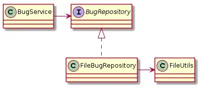

For example, say you have:
You would mock (or otherwise stub out) FileBugRepository when testing BugService, because that's not a static class-level dependency, just one possible arrangement of objects at run-time. But when testing FileBugRepository, you should not mock FileUtils because it is being used directly, and is the only valid implementation.
In this case, FileUtils is a direct static dependency; in most languages the code of FileBugRepository will contain the name FileUtils. So you can't test it with something else without using some low-level magic to redefine the code you are testing to be something other than what it is.
