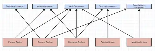

A more complex example would be entity-component systems as used often in game engines. In those cases, the components are often just raw data and classes like the one you've shown. However, their scope/visibility tends to be limited since there are typically only one or two systems that might access that particular type of component. As a result you still tend to find it quite easy to maintain invariants in those systems and, moreover, such systems have very few object->object interactions, making it very easy to comprehend what's going on at the bird's eye level.
In such cases you can end up with something more like this as far as interactions go (this diagram indicates interactions, not coupling, since a coupling diagram might include abstract interfaces for the second image below):

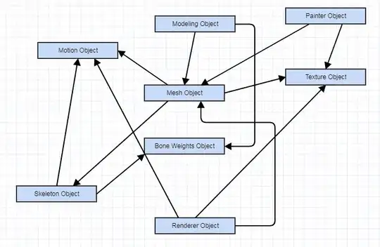

... as opposed to this:
... and the former type of system tends to be a lot easier to maintain and reason about in terms of correctness in spite of the fact that the dependencies are actually flowing towards data. You get much less coupling primarily because many things can be turned into raw data instead of objects interacting with each other forming a very complex graph of interactions.
