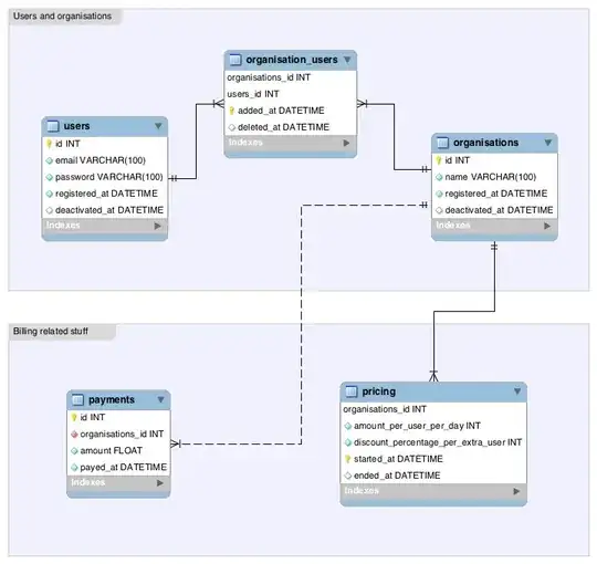

Here's a simplified DB schema I created:
DB Schema
Does this look like it could work?

  • no. you need a BillingEvents table separate from your domain model. this is very much like a log, Events are added and never changed or deleted They all have the same structure, customerId, eventType, date. Again It should link to customerIds in your accounting software rather than a domain model if possible – Ewan Nov 16 '15 at 21:59
  • What is exactly the added benefit of such a table? If all the needed data is present in the domain model, why would I need to add such a table? Would I also use that table to calculate the customer's credit/balance? Just curious. – Willem-Aart Nov 18 '15 at 14:54
