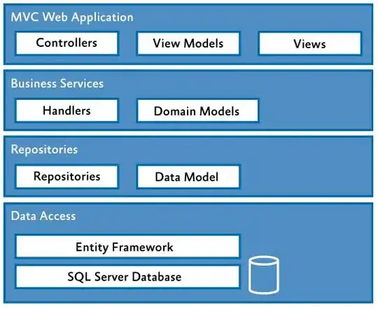

I'm wondering how do I treat the part of my application which is used only for monitoring my local network and storing the information in a database.
Several architectures implement such code differently, but in a layered architecture, you would need to create layers, e.g. DataAccess layer, Business logic layer. etc..
Your Model (there are different types of models) will interact with these layers as required, it all depends on your application or software architecture really.
Do I bend definitions of non-UI elements and try to figure out whether they could fit to either Model or Controller ?
I would say your "non-UI elements" is actually your business logic that needs to go in Model which then can interact with different layers e.g. DB layer etc..
