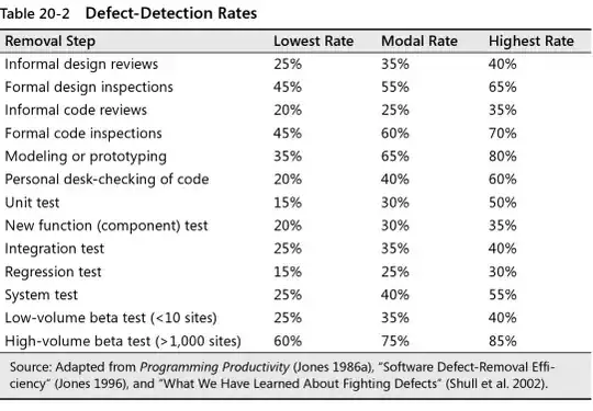

19
Unit tests don't catch all defects. But they are cheaper to set up and (re)run compared that other kinds of tests. The unit tests are justified by combination of moderate value and low-to-moderate cost.
Here's a table showing defect detection rates for different kinds of testing.
source: p.470 in Code Complete 2 by McConnell
Nick Alexeev
  • 2,484
    That data was gathered in *1986*. That was *thirty years ago*. Unit tests in 1986 were not what they are today. I'd be skeptical of this data. Not to mention, unit tests detect the bug *before its ever committed*, so it's doubtful that they would be reported. – RubberDuck Jun 18 '16 at 12:11
    @RubberDuck This chart is from a 2006 book, and it's based on data from 1986, 1996, 2002 (if you look carefully). I haven't looked into the data gathering protocols in the sources, I can't say when they started to track a defect and how it was reported. Could this chart be somewhat out of date? It could. Last December I was at a seminar, and the instructor mentioned that integration tests find more bugs than unit tests (by a factor of 2, iirc). This chart says that they are about the same. – Nick Alexeev Jun 18 '16 at 21:02
