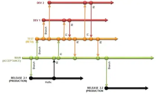

You are somewhat mapped to the Development-MAIN-Production branching model seen below. The area above MAIN is said to be the development area. The area below MAIN is the production area.
Highlights of this model which I consider relevant for you:
  • Your devs needs to Forward Integrate (FI) (FI = merge away from MAIN) frequently (2-3 times a week) into their DEV branches to ensure their latest changes always consider the latest overall developments.
  • Your devs need to Reverse Integrate (RI) (RI = merge towards MAIN) in the TEST branch only when they've reached a feature-completion milestone which they want to expose to QA and for which they're ready to provide prompt fixes in response to QA feedback. The fixes will be performed on TEST branch and immediately FI in their DEV branch.
  • Never RI from any DEV branch into MAIN
  • Always RI from TEST branch into MAIN, exclusively when your QA considers the quality of TEST being OK. Keep a high quality threshold for merging into MAIN. At the very least, your Product Manager must be able to always demo a working version of your Product from the latest commit in MAIN.
  • Create branches in the production area only as needed. Your build server should always tag all branches, including those from development area, and the source of any build/release should be identifiable at all times regardless of the branch it came from.
  • Take releases for production only from MAIN or the production area. If later you need to provide a fix for an exact released version (i.e. you can't just give the latest version from MAIN), create a branch in the production area from the MAIN tag of the faulty release, when the fix is needed. Always fix the problem on the HotFix branch and then immediately RI into MAIN and FI into TEST.
I suspect you have problems because:
  • Your devs RI into TEST code that is not feature-milestone complete
  • Your devs RI into TEST without getting the green light from QA (i.e. QA is not in control of what gets injected into TEST)
  • When QA reports a bug on TEST, your devs fix it on their DEV branch and then RI into TEST. This is a major bad practice because the merge will always bring in other incomplete dev crap. They should always fix it on TEST and then FI into their DEV branch. If it's not fixable on TEST, they delivered total crap in the first place and you have bigger problems.
  • Your devs don't FI often enough from TEST and so they destabilize TEST whenever they deliver there. It's a fine art balancing how often to FI into DEV. Postpone it too much and it will be extremely costly & risky right before delivery, which you never want. Do it too often and you don't get any actual dev work done if you overlap too much with work delivered by other people in TEST in the mean time.
