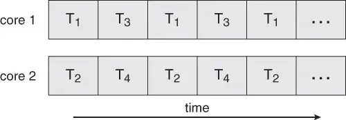

Concurrent execution on single-core system:
Parallelism implies a system can perform more than one task simultaneously.
Parallelism on a multi-core system:

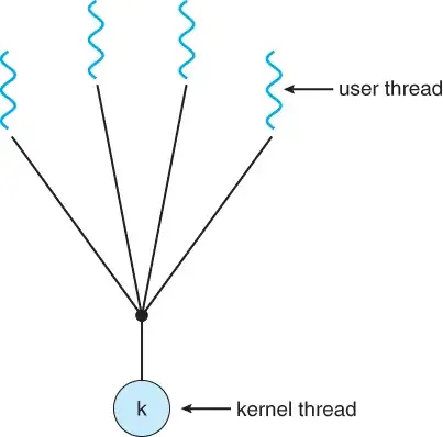

Many-to-one model: true concurrency is not gained because kernel can schedule only one thread at a time.

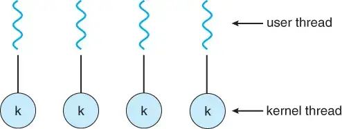

One-to-one model: provides more concurrency than many-to-one model."
My question is why concurrency is not gained in many-to-one model and why one-to-one model provides more concurrency than many-to-one model.
I think that many-to-one model's performance is not gained, but I think concurrency is 4 times greater than single thread. In addition, one-to-one model provides 4 times more concurrency than single thread (same as many-to-one model). Moreover, parallelism is 4 times better than many-to-one model in multi-processor architectures.
My conclusion is the textbook wrote wrongly. So it should be changed like the following
Many-to-one model: concurrency is improved up to the number of user threads, but performance is not gained because kernel can schedule only one thread at a time.
One-to-one model: concurrency is improved up to the number of user threads, and performance is also improved up to the number of processors.

In the many-to-one model, you get concurrency (the appearance that tasks run at the same time) but you can't get parallelism. There is only one kernel thread and that can't be spread over multiple processors.
In the on-to-one model, each user thread has a corresponding kernel thread, which gives the kernel more options to provide concurrency or even parallelism.
