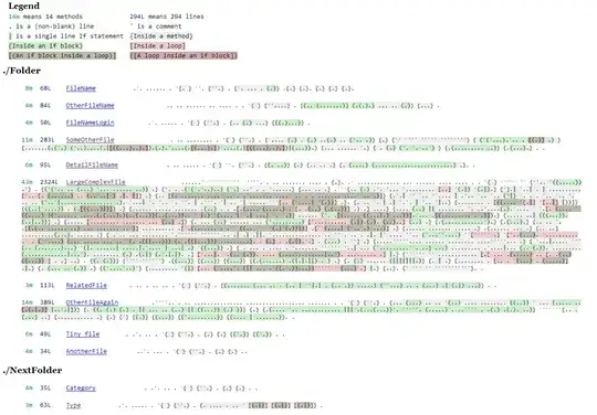

Another approach is to look at the 'signature' of the code shape. The Signature Survey was done by Ward Cunningham
alt text
That legend is a bit hard to read:
  • 14m means 14 methods
  • 294L is 294 lines.
  • . is a non blank line
  • ' is a comment
  • | (green) is a single line if statement.
  • (.) (green) is a single statement inside an if block
  • [(.)] (brown) is a single statement inside of an if inside a loop.
  • {.} is a method with a single statement.
  • [.] (red) is a single statement inside a loop
  • ([.]) (dark red) is a single statement inside a loop inside an if block.
Comparing two sets of code then is looking at the edit distance between two strings with a very limited language.
