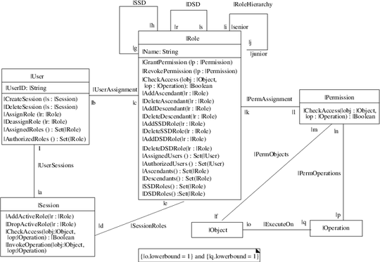

Although @Rotem's answer is excellent he got one detail wrong, you should not check the user for the role. You instead call checkAccess() on the session (not necessarily and HTTP session, I usually call it a security session). This both hides your actual authorization model, ensuring that it can be changed later, and simplifies your calls.
RBAC UML
Also I would like to say that "Permission Based Access Control" is not a real security term, in fact most authorization models have some kind of permissions. What you're talking about is Discretionary Access Control (DAC). Neither model is appropriate for all situations.
I highly recommend reading Chapter 4 (Chapter 6 in 3rd ed) of Security Engineering by Ross Anderson and if you really want a deep dive on RBAC this expensive book is quite good.
1. image from https://www.researchgate.net/figure/RBAC-class-diagram-template_fig2_221367009 I have no idea if this is reasonably the original source, I know i've seen and referenced it before
