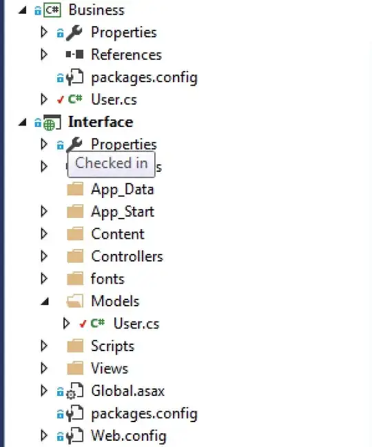

Here is a basic overview of what my solution setup looks like. My business classes (domain models) contains code looking like this :
 public class User

  • Well, to rephrase what I put in my question here, I have a class library project containing my domain models. These domain models have validations in the setters (each setter throws an exception when invalid). Now I would like to use these domain models in my ASP.net project using the code first approach. Therefore I must create classes in my `model` folder of my ASP.net project. To simplify my question a bit : What do I put in my `model` classes so that they work out with my validations from my setters. (Hope this makes sense for you) – Corb3nik Sep 28 '15 at 15:10
  • it makes a bit more sense. But you don't to have a website or put anything in the Models directory to use EF. – Ewan Sep 28 '15 at 15:15
  • @Ewan Indeed, now this is where the code-first approach problem comes in. How would I generate database migrations if I don't use the models directory? – Corb3nik Sep 28 '15 at 15:18
  • @Ewan Edited my question so that you can have a clearer view of my setup. – Corb3nik Sep 28 '15 at 15:25
