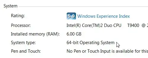

You can also place a sticky note on the choose version page (one similar to this one) explaining how the users can check the OS System Type (a.k.a. right click Computer and choose properties blah blah...) so curious humans can check and be sure that what you offer is the right version.
