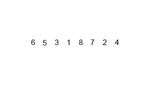

Mergesort is a divide and conquer algorithm and is O(log n) because the input is repeatedly halved. But shouldn't it be O(n) because even though the input is halved each loop, each input item needs to be iterated on to do the swapping in each halved array? This is essentially asymptotically O(n) in my mind. If possible please provide examples and explain how to count the operations correctly! I haven't coded anything up yet but I've been looking at algorithms online. I've also attached a gif of what wikipedia is using to visually show how mergesort works.

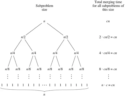

For this, look at the tree below - for each level from top to bottom:
  • Level 2 calls merge method on 2 sub-arrays of length n/2 each. The complexity here is 2 * (cn/2) = cn.
  • Level 3 calls merge method on 4 sub-arrays of length n/4 each. The complexity here is 4 * (cn/4) = cn.
  • and so on ...
At each merge stage, the total cost for merging all pairs is O(cn). Since there are log(n) merge stages, the total complexity is: (cost per stage)*(number of stages) = (cn)*(log(n)) or O(nlog(n)).

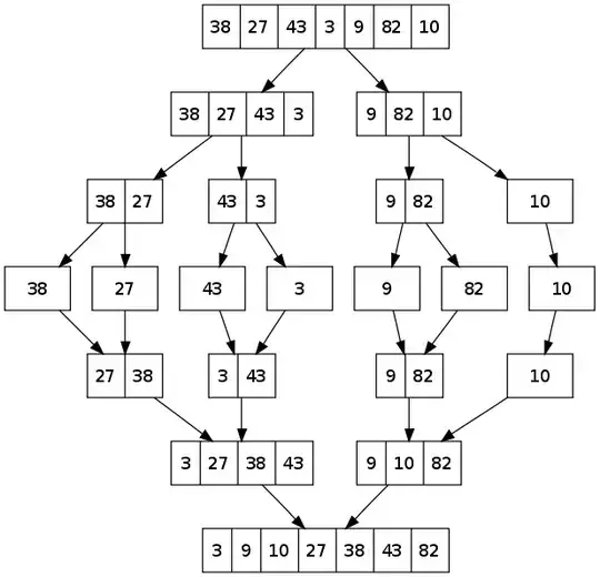

If we take a closer look at the diagram, we can see that the array is recursively divided in two halves till the size becomes 1. Once the size becomes 1, the merge processes comes into action and starts merging arrays back till the complete array is merged.
