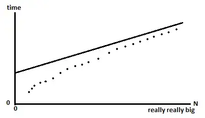

O(n) does not mean time grows linearly with n. It means time is bounded by a line that has some Y-intercept, and some slope times n, like this ...
... no matter how big n gets. The same goes for any other big-O. For example, O(n x m) means there is some bounding curve C1 + C2 x (n x m), and O(n + m) means the curve is C1 + C2 x (n + m).
(Keep in mind that better big-O does not mean better performance, except as n gets large.)
