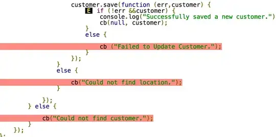

Here's an example of a code coverage snippet from instanbul, I'm using Node.js:
The first miss, failing to update the customer, is something that should definitely be tested. But the last 2, failing to find location and customer, are present on nearly every endpoint. Am I really to pass in an incorrect location, and then an incorrect customer, for every one of the endpoints (create, update, delete, etc.)? Or should I just live with those not being covered?

Especially when talking about error handlers, these have to be covered by tests.3 The “happy path” will be implicitly tested by normal usage. But if things go wrong – you want to make sure things still go your way. It would be a shame if a silly little mistake would mean your error handling code would itself produce an error. Proper errors also make it easier for users of the API to figure out why their code isn't working – they are an important feature of your code.
3. Testing such errors is most important when the errors are supposed to be recoverable, because those errors are part of your business logic and API. This is in contrast to assertions that directly terminate the process and don't allow for further control flow.
In the context of a web API, checking all input can be crucially important for security – defensive programming should be the rule, not an accidental feature. Obviously, this validation needs to be tested!
