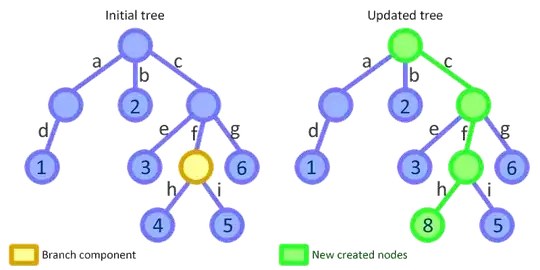

You must watch this great video from 2015 React conf by Immutable.js's creator Lee Byron. It will give you pointers and structures to understand how to implement an efficient immutable list which do not duplicate content. The basics ideas are : - as long as two lists use identical nodes (same value, same next node), the same node is used - when the lists start differing, a structure is created at the node of divergence, which holds pointers to the next particular node of each list
This image from a react tutorial may be clearer than my broken English :enter image description here
