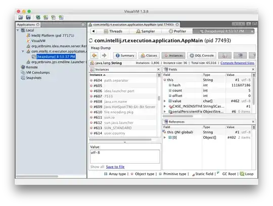

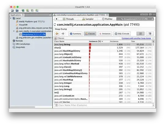

Creating a memory dump is as easy as running a program where you can connect to the various virtual machines. VisualVM can do it quite nicely.
And...
Go to classes, double click on String...
And then you have every instance of a String that is running in the JVM at the time of the memory dump.
While this implies some access to the machine, the key takeaway is that it is really quite easy to get a heap dump and examine it. There's even an SQL like language for it called OQL for doing queries against it.
The reason to use a char[] is to limit your exposure to a memory dump. If you note the line right under the String in the memory dump was char[] and they are in there too.
