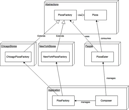

Abstract factory only makes sense, when code that creates the factory is in completely different part of your application than the code that actually uses your factory. None of your examples actually represent this. Quite often, the factory is downstream the dependency between modules. So the code that consumes the created abstraction cannot possibly have dependency on the concrete implementations.
Following illustration shows where abstract factory makes sense.
Usage of abstract factory
This design has few good properties. When modules for concrete implementations(the ChicagoStores and NewYorkStores modules) change, it doesn't require recompilation of either other modules or the one that actually uses the implementations (People). Second, it allows you to add new concrete implementation (maybe WashingtonStores), after which you only need to change the "application" module, which binds everything together. The "composer" object is one that binds everything together. This would often be some kind of Inversion of Control framework. Also note, that the one that uses the factory to create instance needs multiple of those instances. If it only wanted single instance, then the composer can just pass in those instances. There would be no need to complicate the design with abstract factories.
But you might be saying : "Isn't this too complex?" Yes, that is correct. But if you have requirements that would force this kind of dependency structure, this kind of design is unavoidable. You need to weight the advantages you gain by separating the dependencies against complicated design.
One note for the end : If you are just learning design patterns, my personal opinion would be to simply ignore the (abstract) factory pattern. It's use is highly situational and it is more often abused then used properly. As many seem to agree with me and some more.
Also note, that what I described above is a design pattern called "Abstract Factory". There is also a pattern called "Factory" which IMO is just a method that creates objects. Your confusion probably stems from the fact that those two are often mixed together.

  • @RobertHarvey Working on diagram right now – Euphoric Jul 31 '15 at 04:31
