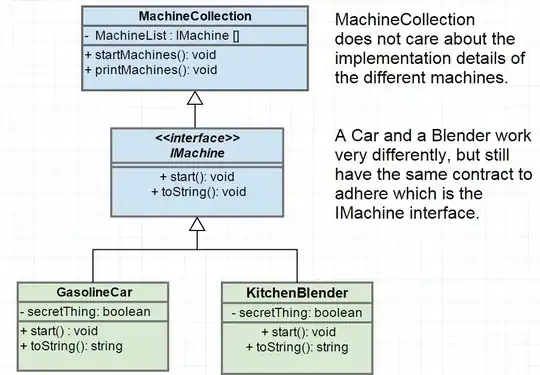

If you really want to guaranty immutability use an interface it has more pros than cons.
Simple interface example: enter image description here
