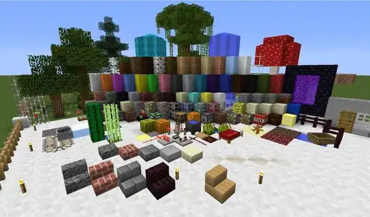

The other suggestion for testing graphics-heavy programs is to create some output that a tester can easily manually verify. A minecraft example is:
minecraft test output
I've also worked on projects that had a bunch of tests that rendered something on the screen, then prompted the tester to manually verify it matched the description. This makes sure you don't forget test cases later.
