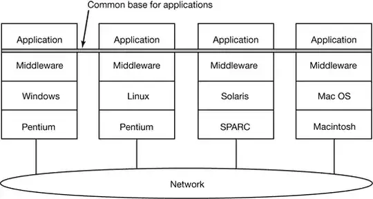

What I found so far and what I asked this question upon is that there exists one layer of middleware, per node in the distributed system. The middleware layers are not directly connected. It is the network underneath the middleware that ensures the connection. The middleware is there to provide an abstraction layer between the application and the network.
See this image:
Each middleware block is separate. that makes sense. Chances are that the middleware for Mac OS is an entirely different thing than the middleware for Windows. On each application builds upon its specific middleware.

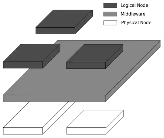

Another way to think about it is that the middleware actually is pretty much the only thing that connects the nodes of the distributed system as can be seen in the image from wikipedia:
This looks like a contradiction. In one scenario, each part of the application talks to its individual middleware, which in turn talks to the node of the network. The middleware is the common base line that separates the distributed application from the distributed system underneath. In the other, the middleware is some big blob that spans across all nodes which means that there is no such thing as individual middlewares for each node.

  • This explains the confusion, in my material, this is not the case. The middleware is a layer that exists once per node and connects each part of the application to its individual node of the network, it's the network underneath that does the connection. I edited my answer and added two pictures of these two apparently different ways to think about it. Or maybe it's just me interpreting them wrong. Could you please elaborate on that? thanks – null Jun 21 '15 at 14:18
  • Well, first of all, middleware may mean different things to different people. That's fine; there are lots of terms in computing that have overloaded meanings. I never use the term unless I'm connecting *two different systems* together. Secondly, you might be overthinking this. The term is not especially important *unless* you are connecting two systems together, in which case the middleware is *that software which is not part of either original system.* – Robert Harvey Jun 21 '15 at 14:20
  • Regarding your edit, the first diagram looks like a *compatibility layer* to me, or simply an ordinary API that can be used by different operating systems (this would be true of a REST layer, assuming the presence of appropriate interfaces in each OS). The second diagram is too abstract to draw any meaningful conclusions. – Robert Harvey Jun 21 '15 at 14:24
