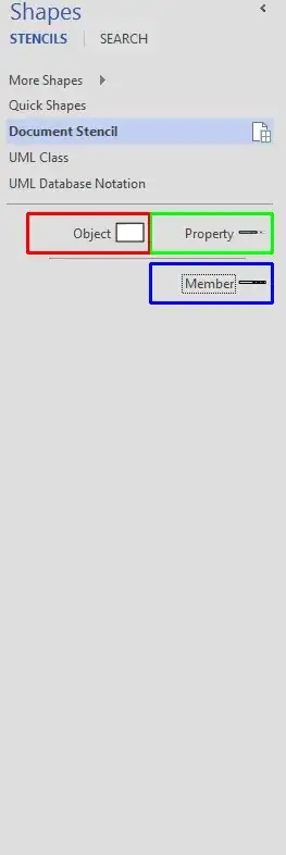

I've created some new Master Shapes in a "Visio Stencil (.vssx)" file as follows:
New Created Master Shapes with used Master Shape
Figure 1 - New Created Master Shapes with used Master Shape

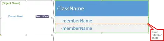

  1. Property Master Shape (Green Box): that is created from the Member Master Shape of the UML Class Stencil (Blue Box).
  2. Object Master Shape (Red Box): that is created from the Plain Container of the Diagram Parts section in the Insert tab of the ribbon.
The Property Master Shape is created to use as the member shape in the Object Master Shape like the Member Master Shape to use in the Class Master Shape of the UML Stencil.
Class Master Shape with its Initial Members
Figure 2 - Class Master Shape with its Initial Members

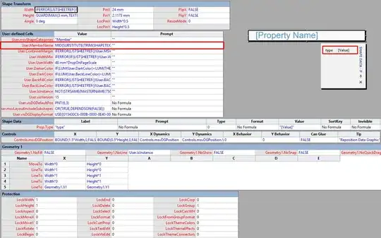

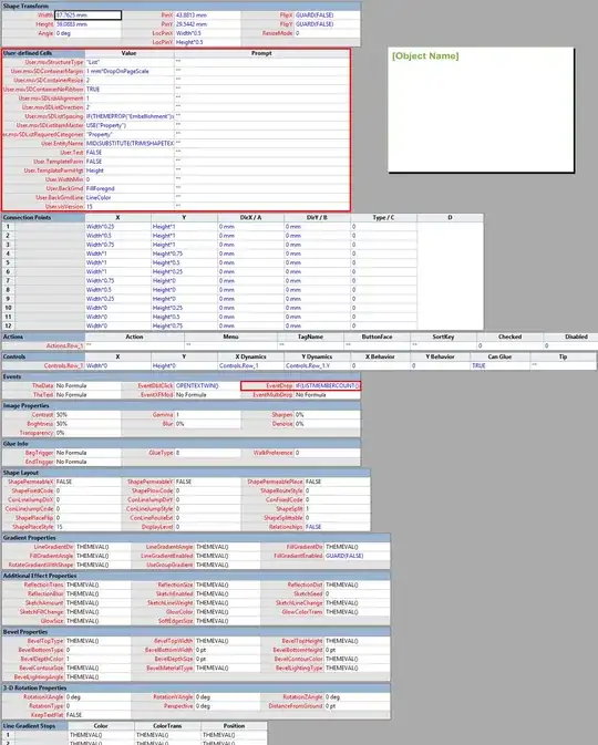

The Property Master Shape that is created from Member Master Shape has changed as follows:

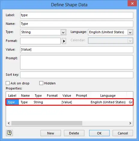

  • I added one Shape Data to it (Figure 3).
    "Shape Data" dialogue box of the Property Master Shape
    Figure 3 - "Shape Data" dialogue box of the Property Master Shape

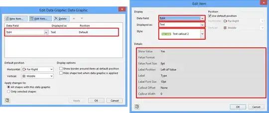

  • I added one Data Graphic Item to it (Figure 4).
    "Data Graphic" and "Data Graphic Item" dialogue boxes of the Property Master Shape
    Figure 4 - "Data Graphic" and "Data Graphic Item" dialogue boxes of the Property Master Shape
  • I changed the "User.MemberName" Formula in the User-defined cells' section of the ShapeSheet window as follows (Figure 5):
    =MID(SUBSTITUTE(TRIM(SHAPETEXT(TheText)),"[",""),1,FIND(" ",SUBSTITUTE(TRIM(SHAPETEXT(TheText)),"[",""))-1)
    instead of:
    =SHAPETEXT(TheText)
    "ShapeSheet" window of the Property Master Shape
    Figure 5 - "ShapeSheet" window of the Property Master Shape

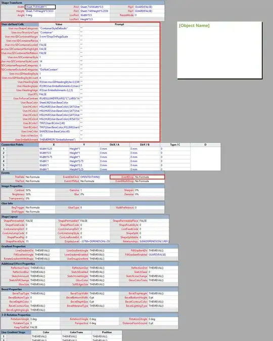

The Object Master Shape that is created from the Plain Container has changed as follows:
  • I changed the contents of the cells in the User-defined cells' and Events sections of the ShapeSheet window as Figure 6:
    Cells in the User-defined cells' and Events sections of the ShapeSheet window after changing their contents
    Figure 6 - Cells in the User-defined cells' and Events sections of the ShapeSheet window after changing their contents
    instead of:
    Cells in the User-defined cells' and Events sections of the ShapeSheet window before changing their contents
    Figure 7 - Cells in the User-defined cells' and Events sections of the ShapeSheet window before changing their contents

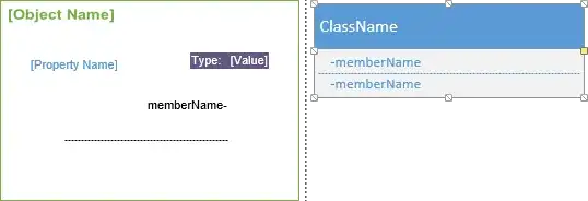

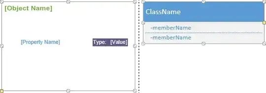

Why isn't/aren't instance(s) of the Property Master Shape arranged and placed correctly after adding it/them to the instance(s) of the Object Master Shape like adding instance(s) of the Member Master Shape to the instance(s) of the Class Master Shape of the UML Stencil (Figure 8)?
Comparing an instance of the Object Master Shape and one instance of the Property Master Shape with an instance of the Class Master Shape of the UML Stencil and its Initial Members
Figure 8 - Comparing an instance of the Object Master Shape and one instance of the Property Master Shape with an instance of the Class Master Shape of the UML Stencil and its Initial Members

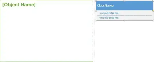

Why do(es)n't instance(s) of the Object Master Shape add its Initial Members after attaching it/them to the page like adding Initial Members after adding Instance(s) of the Class Master Shape of the UML Stencil to the page (Figure 9)?
Comparing an instance of the Object Master Shape with an instance of the Class Master Shape of the UML Stencil
Figure 9 - Comparing an instance of the Object Master Shape with an instance of the Class Master Shape of the UML Stencil
I've added the following Formula for achieving to this objective; However, I think that it doesn't work:
=IF(LISTMEMBERCOUNT()=0,DOCMD(2270),0)

Why isn't displayed a Bar in the instance(s) of the Object Master Shape to insert instance(s) of the Property Master Shape like displaying the Bar in the instance(s) of the Class Master Shape of the UML Stencil to insert its Members (Figure 10)?
Comparing an instance of the Object Master Shape with an instance of the Class Master Shape of the UML Stencil for displaying the Bar to insert related Members
Figure 10 - Comparing an instance of the Object Master Shape with an instance of the Class Master Shape of the UML Stencil for displaying the Bar to insert related Members

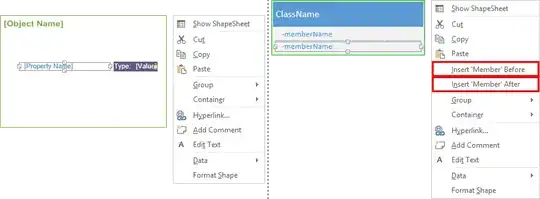

5th Question:
Why isn't/aren't displayed options for inserting Members on the added instance(s) of the Property Master Shape to the instance(s) of the Object Master Shape like attached instance(s) of the Member and Separator Master Shapes of the UML Stencil to the instance(s) of the Class Master Shape of the UML Stencil (Figure 12)?
Comparing an instance of the Object Master Shape and one instance of the Property Master Shape with an instance of the Class Master Shape of the UML Stencil and its Members for displaying Options of the inserting members on the added members
Figure 12 - Comparing an instance of the Object Master Shape and one instance of the Property Master Shape with an instance of the Class Master Shape of the UML Stencil and its Members for displaying Options of the inserting members on the added members

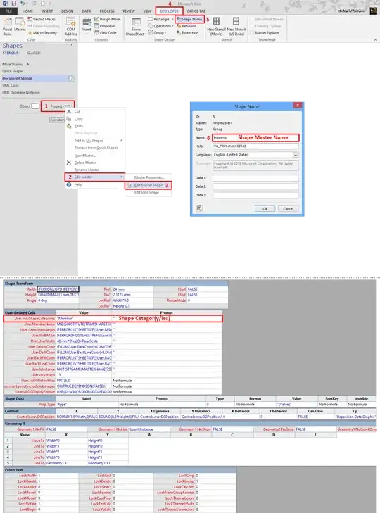

Answer of 1st Question:
This problem always is for don't attend to the "Category" word. In most cases, people don't attend to that word and use the "Shape Master Name" instead of "Shape Category"; however, they're different with each other.
In my case, I was being entered the Shape Master Name (Property) for User.msvSDContainerRequiredCategories (A semicolon-delimited list of category names. Other shapes must have at least one matching name to be allowed as container members.) and User.msvSDListRequiredCategories (A semicolon-delimited list of category names. Other shapes must have at least one matching name to be allowed as list members.) instead of Shape Category (User.msvShapeCategories = Member).
Comparing "Shape Master Name" with "Shape Category"
Figure 1 - Comparing "Shape Master Name" with "Shape Category"
Answer of 2nd Question:
For solving this problem, we must be attended to two things:
First, We must add the shapes that we want to be added them automatically after instantiate the master shape. So, we must add the row(s) for each shape that we want to be added with name User.msvSDListItemMaster[Index] (The name or UniqueID of the master shape to create an instance of for Insert commands. The value must be placed inside a USE() function.).
As you can see, I want to add only one shape. So, I must change the name of the User.msvSDListItemMaster row to User.msvSDListItemMaster1. If I want to add more shapes in instantiate time, I must add another row like User.msvSDListItemMaster2, User.msvSDListItemMaster3 and so on.
Second and the last thing, we must add a formula to the "EventDrop" cell of "Events" section. As you can see, I've added it to my Custom List Shape as what mentioned in here and here:
Specifying an Insertion Shape
There are several ways to add a shape to a list: dragging and dropping the shape, clicking the blue insertion triangle that appears near the list edge, or right-clicking an existing member and inserting a shape. Clicking the insertion triangle and right-clicking to insert a shape both use the User.msvSDListItemMaster cell to determine what shape to add to the list. The name of the master is placed in quotes inside a USE() function (for example, USE("List member master")). If no shape is specified in User.msvSDListItemMaster, Visio will duplicate an adjacent shape in the list when inserting the shape.
It is also possible to automatically populate the list with some member shapes when the list is first dropped on the page. To do this, put the following formula in the EventDrop cell of the list, repeating the DOCMD(2270) once for each member to be added:
IF(LISTMEMBERCOUNT()=0,DOCMD(2270)+DOCMD(2270)+DOCMD(2270),0)
2270 is the command for inserting before an item in a list (visUiCmds.visCmdListInsertBefore). It is also possible to use 2271, the command for inserting after an item in a list (visUiCmds.visCmdListInsertAfter).
The problem is for 2270 number. I don't know why it doesn't work; however, when I checked the above-mentioned cell in the "Events" section of the Class Master Shape of the UML Stencil, I saw that have been used 2499 instead of 2270. So, I used that number in my formula, and it worked. If I have more than one shape for User.msvSDListItemMaster[Index] rows, I must add +DOCMD(2499) for every shape after shape 1.

Answer of 5th Question:
This problem will solve if the problem of the 1st question be solved.
