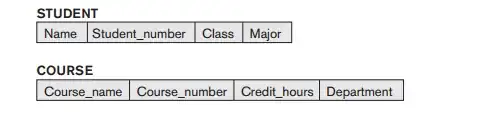

The database schema is like a blueprint that describes the layout of the data contained in the database: what kinds of fields are present and how they are organized. Here's an example :
Changing the schema changes the structure of your particular database.
But what happens when you want to change the very nature of what can be specified in a schema file? : That means a change to the data model used by the database software.
Unlike the schema, the data model is not isolated in a separate file for easy changing, but rather is hard-coded right in the software itself, so changes to it can have a profound impact on the database programs.
One example of a data model would the Relational model.
Changing the data model would mean something like switching to a new data model such as semantic data model. That would change the entire structure of the database management software!
Refer to this page for a detailed explanation.

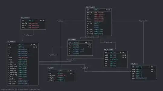

A database model is otherwise its design - a graphic representation of all its tables and the relationships between them. You can make a database model on a piece of paper or in a database design application. If you use the program for this, you will be able to generate a SQL / DDL script for the database, which will make your work easier. Below an example database model:
