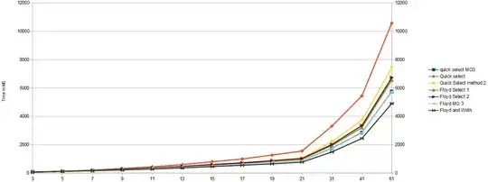

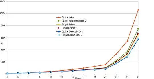

Here is a chart of the results
EDIT I coded the Floyd Routine with the median of 3 and updated the chart. It rates about the same speed as quick select with Median of 3, slightly slower. It deserves a little more exploration.

As you can see, the Floyd routine is faster than any of the quick selects other than the version with the median of 3. I don't see why the median of 3 could not be added to the Floyd routine and I will look at that next. As for the Floyd routine, of course removing the floating point log, exp and sqrt functions speeds up the routine.
I still haven't figured out why Floyd put it there in the first place.

edit 6-13-15
I experimented some more with the Floyd selection routine and started to compare his routine against N. Wirth selection routine. An idea came across, what would happen if I combined his routine with Floyd's routine. This is what I came up with.
float FloydWirth_kth(float arr[], const int length, const int kTHvalue)
#define F_SWAP(a,b) { float temp=(a);(a)=(b);(b)=temp; }
#define SIGNUM(x) ((x) < 0 ? -1 : ((x) > 0 ? 1 : (x)))
    int left = 0;
    int right = length - 1;
    int left2 = 0;
    int right2 = length - 1;
    //while (left < right)
        if( arr[right2] < arr[left2] ) F_SWAP(arr[left2],arr[right2]);
        if( arr[right2] < arr[kTHvalue] ) F_SWAP(arr[kTHvalue],arr[right2]);
        if( arr[kTHvalue] < arr[left2] ) F_SWAP(arr[left2],arr[kTHvalue]);
        int rightleft = right - left;
        if (rightleft < kTHvalue)
            int n = right - left + 1;
            int ii = kTHvalue - left + 1;
            int s = (n + n) / 3;
            int sd = (n * s * (n - s) / n) * SIGNUM(ii - n / 2);
            int left2 = max(left, kTHvalue - ii * s / n + sd);
            int right2 = min(right, kTHvalue + (n - ii) * s / n + sd);
        float x=arr[kTHvalue];
        while ((right2 > kTHvalue) && (left2 < kTHvalue))
            do
                left2++;
            }while (arr[left2] < x);
            do
                right2--;
            }while (arr[right2] > x);
            //F_SWAP(arr[left2],arr[right2]);
        left2++;
        right2--;
        if (right2 < kTHvalue)
            while (arr[left2]<x)
                left2++;
            left = left2;
            right2 = right;
        if (kTHvalue < left2)
            while (x < arr[right2])
                right2--;
            right = right2;
            left2 = left;
        if( arr[left] < arr[right] ) F_SWAP(arr[right],arr[left]);
#undef F_SWAP
#undef SIGNUM
    return arr[kTHvalue];
The speed difference is amazing (well at least to me). Here is a chart showing the speeds of the various routines.
Floyd Selection routine 489 speeds
Andy Dansby
