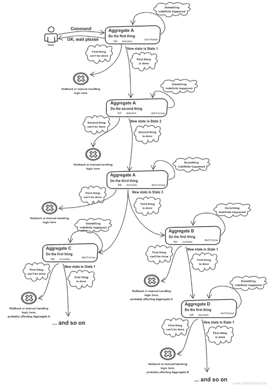

    I _really_ like the _Design for Behavior_ concept. This informs the underlying "data structure" and helps avoid the all too common anemic, hard-to-use classes. plus one. – radarbob Jun 03 '15 at 15:38
  • 1_ Where does that "IEquatable" (which you say you've abbreviated in your answer) belong to? May I know where you wanted to use this interface? 2_ Also about this line: "`return _position.Equals(other._position);`", would this be possible at all? It's accessing a private field of another object(although it's of the same class, it doesn't make a difference, private field cannot be read from an object). – aderchox Sep 06 '21 at 04:02
  • I somehow like the `toDTO()` - I'd probably call it `transfer()` - approach for use cases where you need to access a lot of fields of domain entities in order to make them cross boundaries e.g. in a HTTP API response. It's much better than accessing all the individual fields through getters and putting the data that way into the response, because a `transfer()` method is expressing the purpose very specifically and prevents careless misuse of the countless would-be-added getters on the domain entities. It's easy to spot if some yokel is abusing that method. – Eugene Nov 28 '21 at 02:12
  • ^-- After thinking some more about it I tend to belive CQRS is the correct solution to the problem mentioned in my prev comment – Eugene Nov 28 '21 at 23:05

I add my 2 cents here mentioning SQL-speaking objects approach.
This approach is based on the notion of self-contained object. It has all resources it needs to implement its behavior. It doesn't need to be told how to do its job -- declarative request is enough. And an object definitely doesn't have to hold all its data as class properties. It really doesn't -- and shouldn't -- matter where they are got from.
Talking about an aggregate, immutability is not an issue as well. Say, you have a sequence of states that aggregate can hold: Aggregate root as saga It's totally fine to implement each state as standalone object. Probably you could go even further: have a chat with your domain expert. Chances are that he or she doesn't see this aggregate as some unified entity. Probably each state has it's own meaning, deserving it's own object.
Finally, I'd like to note that object finding process is very similar with system decomposition into subsystems. Both are based on behavior, not anything else.
