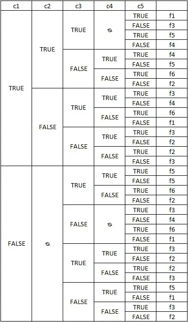

I need to check certain conditions (of size n) on an object and perform one of several options available (size m) based on the result. Seems to me it fits a tree.
Now. The tree is quite large and I wonder if there's a way to reduce it.
Here's a sample of it
The conditions are marked as c1,...,cn and the functions to perform are marked as f1,...,fm (the crossed zeros are dont-care values)

    have a look at [Karnaugh maps](http://en.wikipedia.org/wiki/Karnaugh_map) – devnull May 07 '15 at 07:13
    possible duplicate of [How to turn truth table into smallest possible if / else block](http://programmers.stackexchange.com/questions/102757/how-to-turn-truth-table-into-smallest-possible-if-else-block) – gnat May 07 '15 at 07:15
  • @devnull but Karnaugh maps produce a binary output no? in my case the outcome isn't binary – Yoni Levy May 07 '15 at 07:19
  • @gnat: I consider this question to be more specific than the possible duplicate. It might be that the actual case (unlike the one shown in the table) has a non-uniform tree, where some nodes are only two levels deep, while others are eight levels deep. In the possible duplicate, the answers will force to have the same depth, which can lead to severe and very problematic duplication if the number of branches is big. – Arseni Mourzenko May 07 '15 at 07:54
    @YoniLevy there is nothing preventing you from replacing the `1` and `0` with different values. The implication of *grouping* the values together is the key concept of the Karnaugh map and applicable here. –  May 07 '15 at 14:25

The Karnaugh map seems much easier...
It is, but it also has a limitation: all your leafs should be at the same depth. This is actually the case in the table you've shown, but may not necessarily be the case in the real problem you are attempting to solve.
If, for instance, some nodes are two levels deep while others are eight levels deep, with Karnaugh map, you have to align them to be eight levels deep, which will probably result in severe duplication (but not necessarily in reduced maintainability; it may actually be that maintainability will only increase). With a BST, you don't have to do that.
