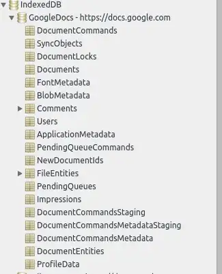

A clearer example might be to look at the tables created by something like Google Docs/Drive:
Google drive
I assume in that scenario indexedDB might be used in several cases such as:
  • Storing edits without having to sync every single character change back to the server immediately
  • Ensuring edits can be synced to the server the next time the page is opened even if the user closed their browser instantly after making the edits originally
  • Avoiding having to reload things that don't change very often, such as a list of fonts or image resources every time the page is reloaded.
indexedDB is particularly useful if you want a client which can be used without an internet connection, which is becoming increasingly important as browser based applications replace more and more desktop applications.
