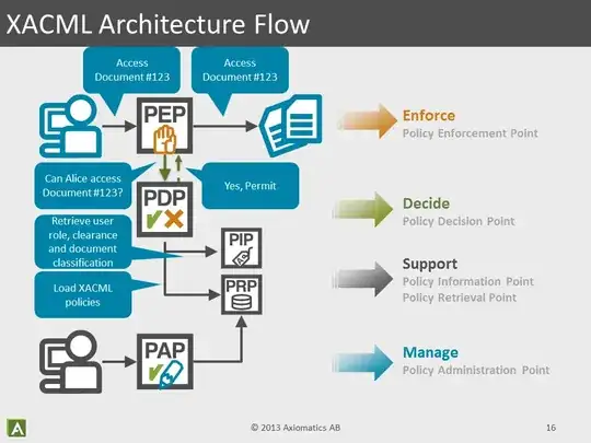

XACML is the solution you are really looking for. It is a type of rules engine that is focused on access control only. XACML, a standard defined by OASIS, defines three parts:
  • an architecture
  • a policy language (which is really what you want)
  • a request / response scheme (how you ask for an authorization decision).
The architecture is as follows:
  • the Policy Decision Point (PDP) is the core part of the architecture. It is the component that evaluates incoming authorization requests against a known set of policies
  • the Policy Enforcement Point (PEP) is the piece of code that protects your application / API / service. The PEP intercepts the business request, creates a XACML authorization request, sends it off to the PDP, receives a response back, and enforces the decision inside the response.
  • the Policy Information Point (PIP) is the component that can connect the PDP to external sources of data e.g. an LDAP, a database or a web service. The PIP comes in handy when the PEP sends a request e.g. "Can Alice view doc #12?" and the PDP has a policy that requires the user's age. The PDP will ask the PIP "give me Alice's age" and will then be able to process the policies.
  • the Policy Administration Point (PAP) is the place where you manage the entire XACML solution (defining attributes, writing policies, and configuring the PDP).
eXtensible Access Control Markup Language - XACML Architecture
Here's what your first use case looks like:
