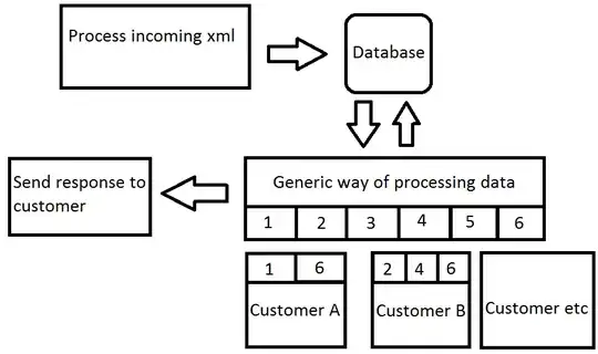

Update: I created this picture in the hope it would give a better understanding of what I want to achieve. As you can see in the picture, each customer has its own set of overrides of the bigger process. Customer specific logic

  • @Dunk I created the picture, I hope it is more clear now. – Mixxiphoid Mar 23 '15 at 19:05
  • Thanks for the diagram Mixxiphoid, it helped a lot. It is what I thought you were asking but wasn't sure. Anyways, Robert's answer should put you on the right track. I haven't used MEF but it seems to do what you want only it seems like it could be a bit much for what you need, but on the flip side might look good on the resume. While not exactly the same it is very similar to what the Entity-Component architecture would get you.... – Dunk Mar 24 '15 at 15:15
