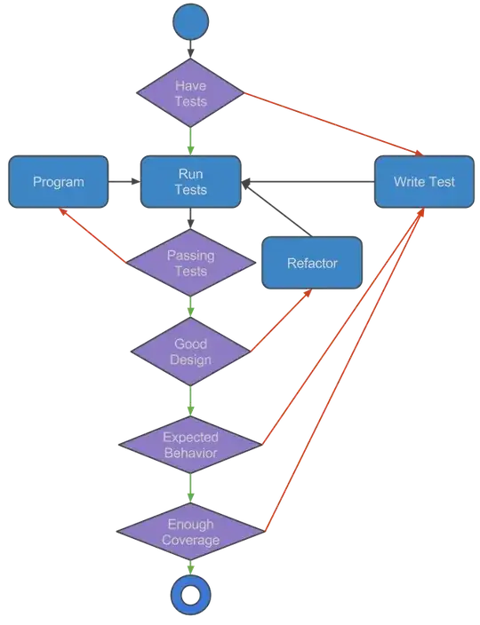

I found a TDD flowchart and converted it to a Google Drawing. I'm using NUnit. I have studied TDD, know what it is and practiced it somewhat. This flow chart is for TDD only; no steps before Unit Testing are included.
enter image description here The flowchart starts out with "Write Test". I had my concept, nothing I had read said I needed anything else first, so I tried following the flow chart. It was too much of a leap to go from "foggy notion" to Unit Test. This caused me "designer's block". Then I read someone say "just do it!" I tried that, but the resulting tests and ensuing code wandered somewhat aimlessly since there was nothing to guide what tests to write.

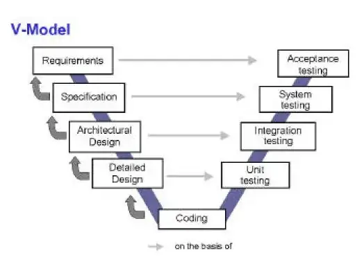

You cannot jump directly from "idea" to "implementation". Good example is the "V model" : enter image description here
You start at high level go lower and you write tests on each level. And each level gets more specific in both implementation and testing. For example you write an acceptance test that says that you should be able to add a customer. This results in you writing an integration tests to ensure client can be both created and inserted into database. And this forces you to write unit tests that describe detailed conditions for creating and saving the customer object. And then you implement the code until unit test pass, this will make integration tests pass and that will make acceptance tests pass. So you get few high-level acceptance tests, more integration tests and lots of small and detailed unit tests.
