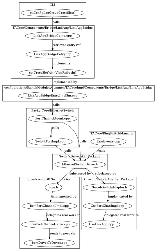

For finding overall structure, I've found creating a dependency graph often helps. I do this manually using graphviz as I've found the manual work helps me learn it, but there are probably automated tools available. Here's a recent example from a feature I'm working on. I've found this is also an effective way to communicate this information to my colleagues.
dependency graph
