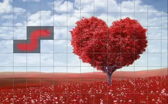

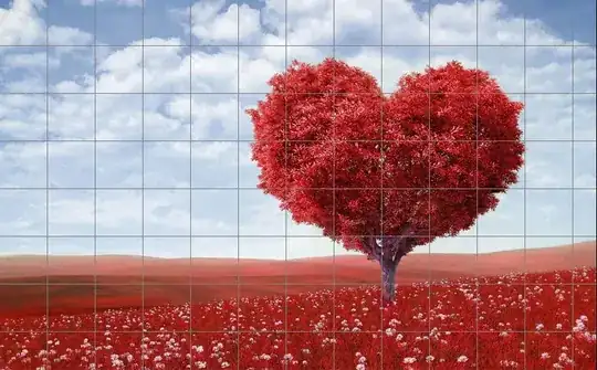

So I came up with a much simpler approach which would let me just apply the same approach to undoing image operations and also making them non-destructive: one approach to rule them all. And that boiled down to just thinking of an image as a collection of image tiles, say 64x64 pixels each:
Now before the user starts painting, you can just copy the whole damn thing into an undo entry, except the copy only shallow copies reference-counted pointers to each image tile. Then as the user starts painting over the image, you make the image tiles which are changed unique with an approach similar to that of immutable persistent data structures or you can use copy-on-write per tile (whatever type of interface and usage pattern suits you; the whole point is to avoid copying the image in its entirety when only parts of it are modified):
Now you can just allocate the image tiles which have been touched by the operation (the dark tiles above which were touched by the user). You can shallow copy the untouched tiles.
With this approach, no matter what image operation is being applied whether it's drawing shapes and strokes or an image filter applied to an image selection or mask, your undo logic boils down to this:
