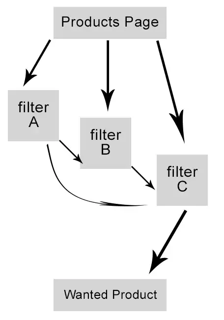

My boss gave me a project with a particular logic. I have to develop a web page which has to lead the navigator through many cases until he/she arrives at the product.
This is the path scheme of the navigation in the site:
Path Scheme
IMPORTANT!
In the Products page the navigator can choose which filter he wants.
  • If A, he/she MUST go through the B (and then C of course) or C and reach the products.
  • If B, he/she MUST go through the C and reach the products.
  • If C, he/she reaches directly the products.
Of course if I start from A I am following the longest path and when I reach my products I have 3 active filters.

I'm here to ask what would a more expert programmer have done in this situation. I didn't respect the DRY principle, I don't like it and I'd like to know an alternative way to develop this kind of logic.
I thought about splitting every section of code in functions but is it a good idea in this case?

  • The control flow diagram shows all control going through `filter_C`, but the conditional statements indicate that control flow can go around `filter_C`. Is `filter_C` optional? – CurtisHx Mar 06 '15 at 12:59
  • @CurtisHx Filter C is mandatory. Yes sorry my mistake I made copy-paste. – Kevin Cittadini Mar 06 '15 at 13:18

In this case, it is important to separate the logic of filtering, and the control flow of how the filters run. The filter logic should be separated out into individual functions, that can run independent of each other.
ApplyFilterA();
ApplyFilterB();
ApplyFilterC();
In the sample code posted, there's 3 booleans filter_A, filter_B, and filter_C. However, from the diagram, filter_C always runs, so that can be changed to an unconditional.
NOTE: I am assuming that the control flow diagram is correct. There is a discrepancy between the posted sample code and the control flow diagram.
A separate piece of code controls which filters get run
ApplyFilters(bool filter_A, bool filter_B)
    listOfProducts tmp;
    if (filter_A)
        ApplyFilterA();
    if (filter_B)
        ApplyFilterB();
    ApplyFilterC();
There is a distinct separation between controlling which filters run, and what the filters do. Break those two pieces of logic apart.
