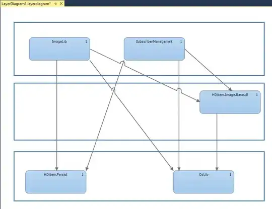

{ If you download the preview version of Visual Studio "15" (which is a ultimate VS; as long as it is still available) you can open your project and pick New Diagram from the Architecture menu (right next to Tools), chose Layer Diagram and play a little bit around - there is a how-to video linked after you created your first diagram. The following screenshot shows the generated diagram that you get when you drag in some of your libraries from the Solution Explorer, right-click on it and select generate dependencies. }
LayerDiagram to show as implemented in Visual Studio "15"
