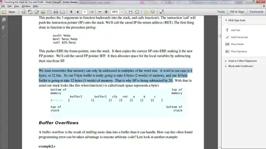

The paper says that a stack will have the following structure. It also says that the word size is 4 bytes. I read up on word sizes and determined that on a 64-bit OS that is not "long-enabled" the word size is still 32 bits or 4 bytes.

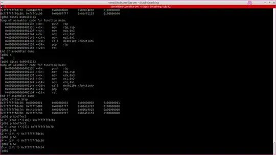

I do not get the same stack structure as the paper. Yes, I'm aware that the paper was published in 1998 but I haven't found any article on the internet stating that the stack structure has been modified greatly. Here's what my stack looks like (I'm also uploading GDB screenshots for verification, in case I've misinterpreted the stack):
    Lower memory                                                Higher memory
    | int c   | int b   | int a   | buffer1  | buffer2  | RBP     | RET     |
    | 4 bytes | 4 bytes | 4 bytes | 16 bytes | 16 bytes | 8 bytes | 8 bytes |

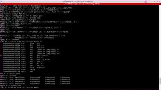

So, if the parameters and the 2 character buffers are pushed onto the stack then the total space occupied by the stack is 48 bytes (or 0x30 bytes). Since, it is 8 bytes for 3 integers amounting to a total and 24 bytes and 8 bytes for buffer1 and 16 bytes for buffer2, we arrive at our grand total of 48 bytes which is corroborated by the GDB screenshot.
However, the GDB stack also shows that the integers (a, b and c) have only been allotted 4 bytes each. The buffers also occupy the size declared in the program (obviously). Is this why I see the slack?
Slack = 48 - (5 + 10 + 4 + 4 + 4) = 21 bytes
Am I right?

  • One more question, why is 48 bytes of space allocated to the stack in `function`? Please refer screenshot 2. – Torcellite Jan 30 '15 at 01:39
  • I've updated the question, sorry for the flurry of comments. – Torcellite Jan 30 '15 at 02:11
