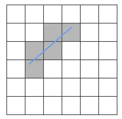

Then you can rasterize your line into the grid using Bresenham, like so:
Now to find the closest point to the segment, look for the points inside the cells plotted by the line. If you don't find any points, then expand and look for all points in the neighboring cells and so forth in a breadth-first fashion.

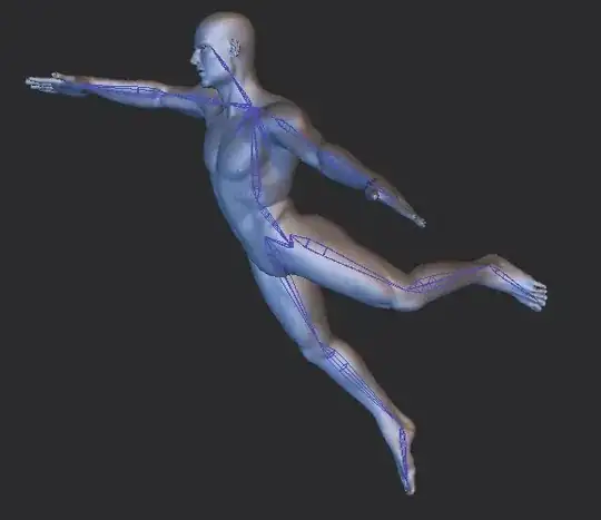

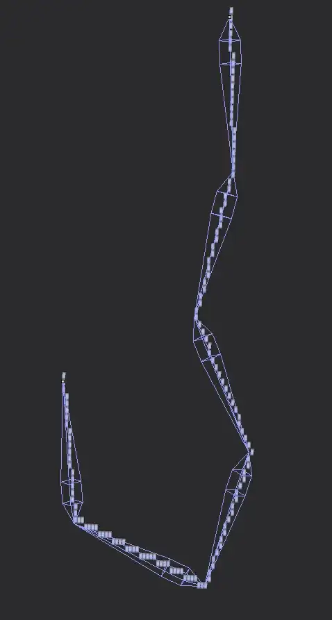

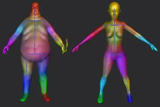

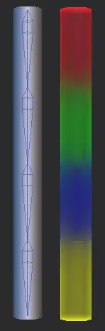

I'm assuming besides having a boatload of points, you also have many line segments as well to search against. I also used this type of solution except in 3-dimensions and my goal wasn't to find the nearest point to a segment, but which points were closest to which segments. My goal was to find them for 3d line segments representing a bone in a skeletal hierarchy, like so:
Using a 3D bresenham rasterizer using a voxel kind of approach:
... to then produce bone weights for characters:
... and start animating 'em:
In a stress test I was able to generate the skinning weights for a mesh with a million vertices (points) against a few hundred bones (3d line segments) in about 20ms just using this plain old dumb grid approach to it. I wanted that kind of performance so that artists could just draw the bones into the character and start animating it, tweak the bone positions, etc. without waiting for a progress bar each time.
