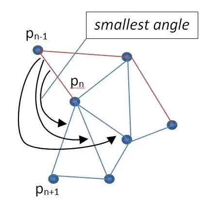

A triangulation of your point set gives you for each point a list of "adjacent" points, the neighbours to which a point is connected.
Once you have calculated the triangulation, you can determine the outer edges by applying an algorithm similar to the classic gift-wrapping algorithm for convex hulls. You start with, for example, the "rightmost" point (which is part of the convex hull and so at the outer edge). Then step from point to point using only outer edges of the triangulation. The only difference to the "convex hull" algorithm is, when having points p_(n-1) and p_(n), you choose p_(n+1) as the point among all adjacent points minimizing the angle between p_(n)->p_(n-1) and p_(n) ->p_(n+1).
Hope this helps.
example for going from p_n to p_(n+1)
