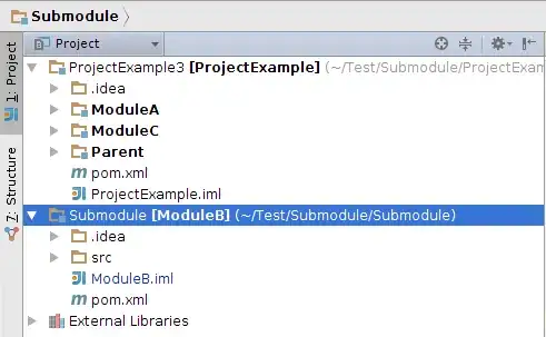

Use IntelliJ import Module
Instead of trying to integrate the "external" repository directly into my current project, I cloned the ModuleB repository to a different directory. Then I imported the said folder as a new module in IntelliJ. enter image description here
IntelliJ then asks if there sould be a dependency between the newly added ModuleB. Unfortunately this only adds an entry into the .iml file
<orderEntry type="module" module-name="Submodule" />
and not into the pom.xml file. So this information where to obtain the source for the module is only available in IntelliJ. How could this problem be addressed? I only tried it with a toy project so far, but if someone wants to import the whole project into Eclipse for instance, this might cause a problem. How could I reference the other GitHub repository in a useful way?
