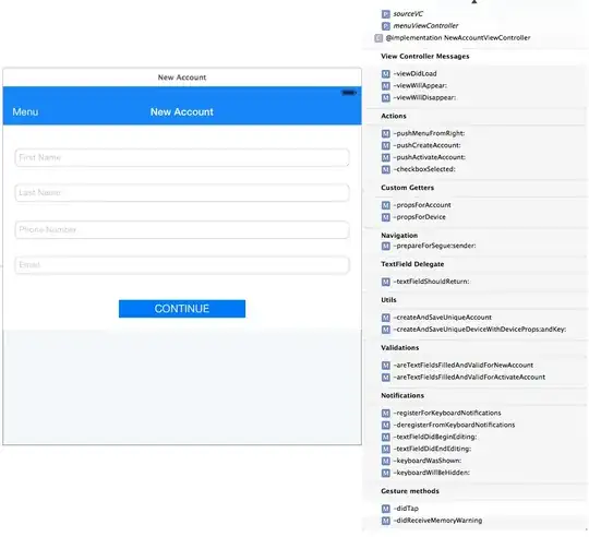

1) The Form Screen: enter image description here

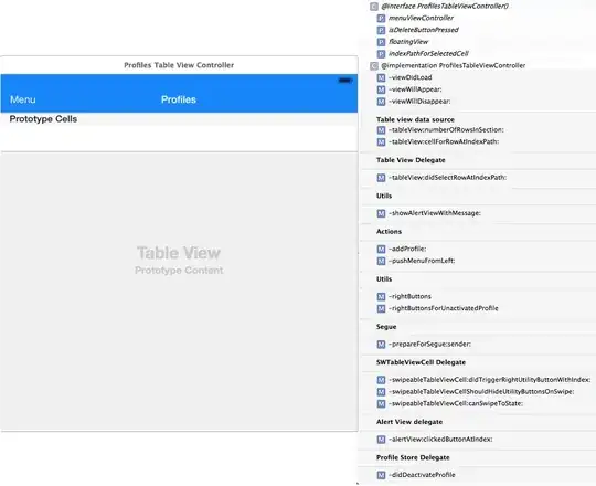

2) The Table View Controller Screen enter image description here

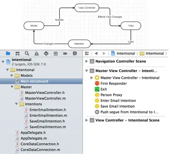

  1. First Solution: https://bendyworks.com/single-responsibility-principle-ios/. This is based on Notifications, it completely separates the View Controller from the (Intentions) View Model and thus reduces code in the View Controller. I think that it has the downside of breaking code, similar to Go-To structures. It looks like this: enter image description here
