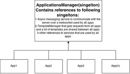

Using Dart in the client part of a web app where I have an application manager that contains a List of application instances and references to services that are used by each application as in the following diagram
diagram
As you can see the application manager is a singleton, so are the services that it contains which are used by all apps, to me it makes sense because
  • I need to have only one instance of the ApplicationManager and each service
  • Easier to access services without the need to pass references
  • I need to preserve the state of each service
  • Almost all services have a cache
I found ways to avoid having the services as singletons which is by making them private to the library which is a feature in dart, so I initialize the services only once from the application manager, but I can't make the ApplicationsManager private because its at the top most level of the library, I would appreciate your thoughts for a way to avoid having the application manager as a singelton.

i need to have only one instance of the ApplicationManager and each service
Then create one instance. shrug
easier to access services without the need to pass references
Then provide a global variable to access that one instance you created previously. If you don't like global variables for this, you can't like singletons, because singletons share all the same drawbacks, but are somehow more complex. In that case, just pass things along to whatever needs it.
    Many programmers seem to think Singletons are better than global variables because they have been told that global variables are bad, whereas Singleton is a Design Pattern, and Design Patterns are good, right? ;) – fredoverflow Dec 22 '14 at 16:41
  • Unfortunately you're right, some people don't consider the flip side of the design pattern coin. Luckily though, many people are aware of issues with the singleton. But it's sad to think design patterns are being applied "mindlessly" :/ – Dylan Meeus Dec 22 '14 at 19:06
