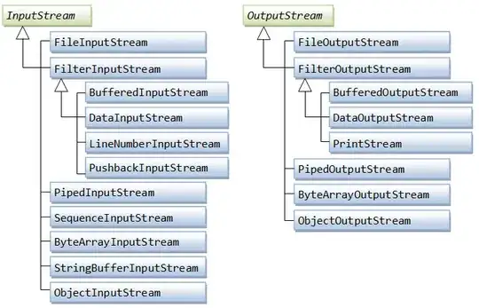

It make sense to see close() as non-core functionality of stream objects. This is the reason this method is placed in interface Closeable. One evidence is that class ByteArrayInputStream does not require the close() operation.
public abstract class InputStream implements Closeable {}
public abstract class OutputStream implements Closeable, Flushable {}
Based on the above definitions my observation is that interface Closeable should not be implemented by abstract class InputStream/OutputStream; it has to be left to concrete sub-classes (like class FileInputStream) to implement it.
Do you think my understanding is correct?

  • it is part of it, the closeable interface is a retro fit – ratchet freak Dec 20 '14 at 14:40
  • Do we need to introduce `interface Closeable` to retrofit? – overexchange Dec 20 '14 at 14:46
  • Does `class ByteArrayInputStream` require `close()` operation? I guess `close()` operation is mainly required when you communicate via file descriptors of the process. – overexchange Dec 20 '14 at 14:55
  • @ratchetfreak Only correction for the current impl could be, `interface Closeable` should have been implemented by concrete sub classes of `abstract class InputStream` instead of `InputStream` itself implementing it. – overexchange Dec 20 '14 at 15:04
