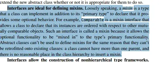

Interfaces are ideal for defining mixins. Loosely speaking, a mixin is a type that a class can implement in addition to its "primary type" to declare that it provides some optional behavior. For example, Comparable is a mixing interface that allows a class to declare that its instances are ordered with respect to other mutually comparable objects. Such an interface is called a mixin because it allows the optional functionality to be "mixed in" to the type's primary functionality. Abstract classes can't be sued to define mixins for the same reason that they can't be retrofitted onto existing classes: a class cannot have more than one parent, and there is no reasonable place in the class hierarchy to insert a mixin.

One of the good reference also supports this point:
Joshua Bloch - Effective Java

  • @paul this is another example, why peripheral behaviour `close()` sit in `interface Closeable` instead of `abstract class InputStream`, because `class ByteArrayInputStream` do not require `close()` operation. `interface Closeable` woulc have been left for concrete class to implement it instead of `abstract class InputStream` implement it. – overexchange Dec 20 '14 at 14:59

You're quoting your reference (Joshua Bloch, Effective Java) out of context. It isn't stating one particular purpose for interfaces and that they should only be used for that purpose. It's enumerating a (non-exhaustive) list of possible applications for them, all of which fall under the general heading "Prefer interfaces to abstract classes". How you get from this to deciding that List<> would be in some fashion better as an abstract class, I'm not quite sure, but it seems that you're picking up details of Bloch's argument without comprehending the overall purpose of it.

  • there is actual content to read in this attached paragraph(in the query) than concentrating on single line of heading. I would not care, what heading tells me. His paragraph clearly explains when to use `interface` and when to use `abstract class` – overexchange Nov 14 '14 at 13:40
    No, the paragraph you've highlighted clearly explains *one particular circumstance* in which to use `interface` rather than `abstract class`. There are others, many of which are listed in the surrounding paragraphs. – Jules Nov 14 '14 at 13:41
  • paragraph talks about the basic thought process to be involved while introducing `interface` or `abstract class`, in its entirety. – overexchange Nov 14 '14 at 13:45
