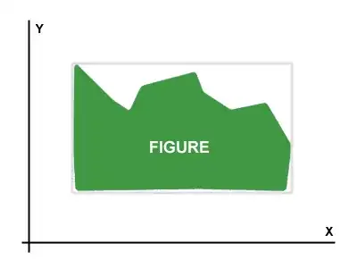

I have a Figure represented through a matrix of bytes (bitmap-like matrix). Example Figure is shown on the Picture 1.
The goal is to find the best rotation angle of some given Figure. When Figure is rotated by best angle, the rectangle that is parallel to X and Y axes and inscribes the Figure has the smallest area.

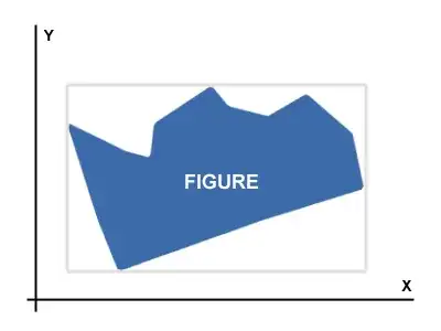

Rectangles that inscribes the figure are shown as light-gray on the pictures. In the Picture 2, you can see that ideal rotation of the Figure is about 30 degrees clockwise.
