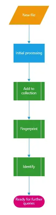

I've implemented the following chain that is mandatory before querying the service about a song's details:
Not much to say except that before being able to query song data, we need its fingerprint and a song ID returned by the Identify sub-process. Of all these steps, they all happen locally but the last one (Identify).

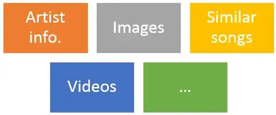

Now about the part of the system I'm seeking for advices:
Above are the different types of queries that can be requested for a song, they are not inter-dependent as we already have the only thing needed, the song ID (diagram 1). Note that I've only put a few but there are nearly 30 of them (see here).

  • easily extensible when for instance, I implement a new type of query.
  • easy to use, I just enqueue a query to the chain and wait for a response

I am using C# with Dataflow (Task Parallel Library), currently I've had some good success implementing diagram 1 using this approach.

Use a finite state machine for the "chain," where each step in the chain is a sub-state. For example, the states may be:
  • Start
  • Initial processing
  • Adding to collection
  • Fingerprinting
  • Querying
  • Ready
Finite state machines are good for coordinating asynchronous operations. I would also add tracing or logging to indicate when a state transition occurs.
